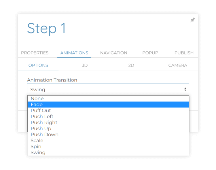

When you progress through steps its great that Cadasio will automatically animate between them, however sometimes it may not look as nice as you want, and whilst you can control how things animate, step transitions can be a quick and simple addition to your project that will really make it stand out.
Either when creating a step or editing an existing steps settings go to the animation tab and you will see the transition drop down. We have different types available to you, each has a different style of animation, simply choose the one you want and then save the settings.
Now rather than Cadasio animating the individual components changed properties the step transition is show, affecting the whole scene instead.
This can be a great way to transition between big changes or just add a bit of flair to your presentations.
